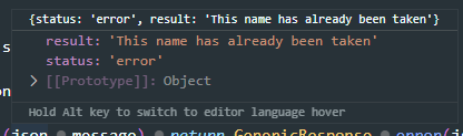

But there's another issue, we cannot create custom field with a same name on 2 different users ? (screenshot attached)
We're trying to create custom field "Visitor ID" on two different users.
Keep getting "The name has already been taken." :confused:

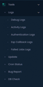

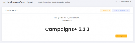

here's what we see on the update page and on the side menu.
where can we find our changelog ?

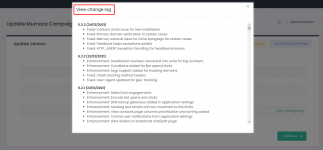

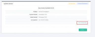

You can find the changelog two place
1- on the header Notification
2- 2nd step of the update
A snapshot is attached for your review.
