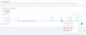

mohammad
Member
Staff member
Aug 31, 2020
58
17
8
You are welcome :)
Next time you have to remove the PMTA server from Mumara, you can select the Rollback option to remove PMTA. It will remove all sending nodes and sending domains.
A snapshot is attached for your review.
