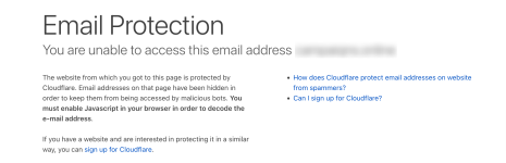

@vector_di I have done an initial look-up in your case. You need to turn off Cloudflare for this domain and then try again after a few hours once the DNS cache has been flushed. Cloudflare is encoding the email addresses when a curl request is made on your domain; and its taking more time to decode the values during the preparation. I have written it at several places not to use Cloudflare proxy unless you are a super tech person and know what options may cause what issues.
wasif
Administrator
Staff member
Apr 9, 2019
594
114
43
I have looked into the database, and a simple SELECT query is taking a long due to Cloudflare. It has to decode the emails. Look at the snapshot below
