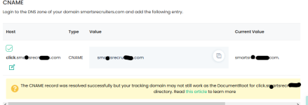

I have changed the CNAME name and update the DNS Records.
I am getting this ERROR:
The CNAME record was resolved successfully but your tracking domain may not still work as the DocumentRoot for click.sma**sre****te**.com isn't pointing to the Mumara directory. See attached!
Please advise, thank you.
It's because it's not sufficient. However, half the work is done, i.e., your domain is pointing to the Mumara server, but your server isn't welcoming the tracking domain requests. In this case, you must add the tracking domain to your server and point it to the Mumara folder. I noticed that the same answer had been given to you in multiple tickets and threads :-). If you are unsure on how to add a domain entry to your web server, you can find an expert to do this job, or Googling it would help more. e.g., I found this
